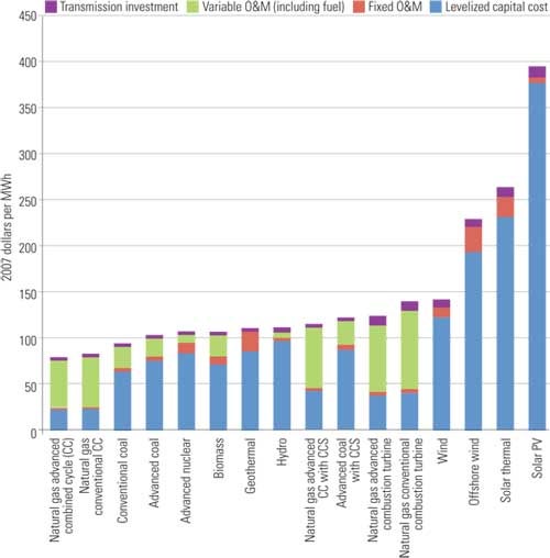

This study’s levelized costs for carbon capture and compression are significantly higher than those estimated in previous studies. According to a May 2009 survey by the U.S. nonprofit group Institute of Energy Research, the Energy Information Administration’s Annual Energy Outlook 2009 puts levelized costs for an advanced coal-fired power plant with postcombustion capture and storage entering service in 2016 at $122.60/MWh (or 12¢/kWh). This compares with $103.50/MWh for an advanced coal plant of the same capacity factor, but without CCS (Figure 2).
2. CCS cost controversy. A July study from Harvard’s Belfer Center estimates that electricity produced by the first coal plants to employ precombustion carbon capture and sequestration technology could cost 10¢/kWh more than estimates for conventional plants, which range between 8¢ and 12¢/kWh. A survey of levelized costs in the Energy Information Administration’s Annual Energy Outlook 2009 by nonprofit group Institute of Energy Research finds that electricity from an advanced coal plant with carbon capture and sequestration (CCS) using postcombustion capture and entering service in 2016 will cost 12¢/kWh. Levelized costs for an advanced coal plant without CCS at the same capacity factor are estimated at 10¢/kWh. Note: Capacity factors for each technology differ. Courtesy: Institute of Energy Research
