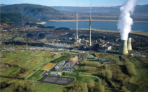

4. A commercial demonstration. The Compostilla OXYCFB300 Project, one of six similar projects funded by the European Union’s European Energy Programme for Recovery, is a carbon capture and storage commercial demonstration project at ENDESA’s Compostilla Power Station in northwest Spain. The circulating fluidized bed supercritical oxy-combustion plant will be scaled up to demonstration size at 300 MW if initial phases are successful. Courtesy: CIUDEN
CIUDEN CCS developers said their project is a “world first” for a carbon capture plant that uses oxy-combustion, burning coal in a CFB at such a scale, and “with the main aim of obtaining the design parameters of commercial power generation facilities at a larger size.”
