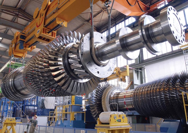

A brainchild of Siemens and Westinghouse engineers, the H-class consists of more than 7,000 individual parts (Figure 1). The largest model available weighs a stunning 444 metric tons—as much as a fully fueled Airbus A380—and, according to Siemens, the distance between the blades and the housing is as small as the thickness of a postcard. The company adds: “Turning at more than 1,700 kilometers an hour, some parts of the turbine blades exceed the speed of sound when in operation.”
1.     In a class of its own. Siemens Energy marked commercial availability of its SGT6-8000H gas turbine, shown here, this June. The so-called H-class gas turbine is the result of a nearly decade-long development phase and is the highest efficiency class currently available, Siemens says. The SGT5-8000H was tested more than 1,500 hours at a simple-cycle power plant at Irsching 4 in Bavaria, Germany. Courtesy: Siemens Energy

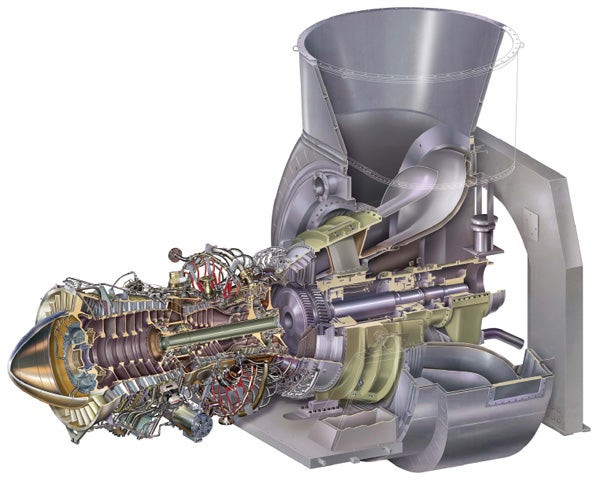

2.    Dash for gas. Gas-powered generation is gaining ground against coal in the UK, too, fueled by a recent plunge in natural gas prices, new shale gas mining, and campaigns against new coal plants. The growing market prompted Rolls Royce to launch the H63, the latest addition to a range of industrial gas turbines. This engine delivers 11 MW more power but in the same footprint as the RB211-GT61, and with an improved efficiency of up to 41.5%—the best in the 35 MW to 45 MW range, Rolls Royce claims. Courtesy: Rolls Royce
Like Siemens, anticipating increased demand for high-efficiency gas turbines, UK company Rolls Royce in June rolled out the H63 (Figure 2), the newest model of its industrial RB211 gas turbine series. The 44-MW engine can deliver at least 30% more power than earlier models, Rolls Royce claims, with a thermal efficiency of up to 41.5% as well as operational flexibility. The technology builds on Trent aero technology and features high-pressure turbine rotor blades and intermediate compressor stators and rotors.
