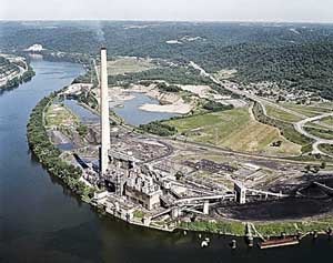

The Burger Plant, which employs 102 people, first came online in 1944; additional units were completed in the 1950s. Units 4 and 5 today provide a combined 312 MW of load-following power. A peaking unit rated at 94 MW remains in operation at the plant, but the company has not specified whether it will continue operating that unit (Figure 1).
1. The coal burn. In April, FirstEnergy Corp., owner and operator of the coal-fired R.E. Burger power plant, decided to retrofit Units 4 and 5 to combust biomass. The decision signals the start of a trend for coal-fired plants in the U.S. Courtesy: FirstEnergy Corp.
