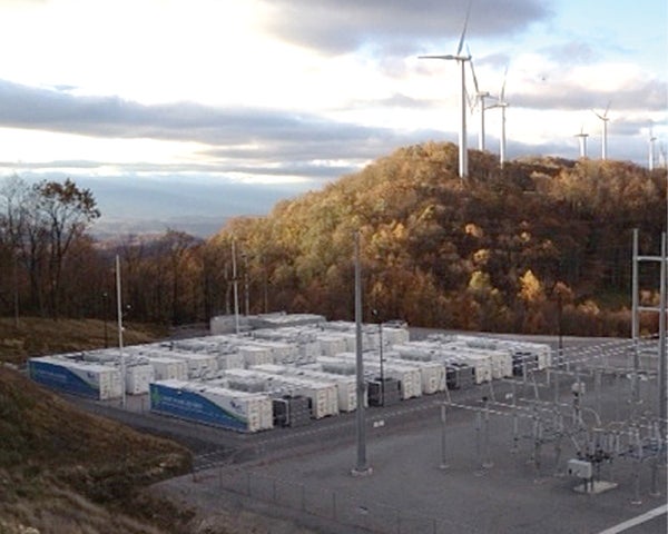

Grid storage projects for renewable generation are getting bigger and more widespread, and many rely on lithium-ion battery technology. In late October, for example, AES Wind Generation and AES Energy Storage put into commercial operation AES Laurel Mountain, a wind generation plant in West Virginia comprising 98 MW of wind generation (from 61 GE 1.6-MW turbines) and 32 MW of A123 Systems energy storage devices (Figure 2).
2. Cost breakthrough. Stanford researchers have used nanoparticles of a copper compound to develop a high-power battery electrode that is reportedly so inexpensive to make that it could be used to build batteries big enough for economical large-scale energy storage on the grid. The development could result in a breakthrough for large-scale battery storage projects like AES Energy Storage’s newly built AES Laurel Mountain, a wind generation plant in West Virginia composed of 98 MW of wind generation and 32 MW of integrated battery-based energy storage. Courtesy: AES Energy Storage
