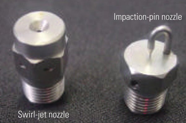

Two types of nozzles are commonly used for inlet fogging: impaction-pin nozzles and swirl-jet nozzles (Figure 3). Both designs operate on the principle of converting high water pressure into increased velocity as water passes through a tiny nozzle orifice. As water exits the nozzle orifice, it forms a conical sheet of water that gets ever thinner the farther it moves from the orifice. Surface tension causes the cone to first break down into fingers of water, and eventually, air instability breaks these fingers down into minute droplets for fast and efficient evaporation.
3. Two fog nozzle types. Two types of nozzles are in general use for gas turbine fogging applications: impaction-pin nozzles and swirl-jet nozzles; impaction-pin designs predominate. Courtesy: Mee Industries Inc.
Although they operate on the same principles, the designs differ in how they create that cone of water, and this affects the size of droplets produced. Impaction-pin nozzles consist of a smooth, short, straight-through orifice with a specially engineered impaction pin in front of the orifice. A fine jet of water is emitted, which immediately strikes the pin, causing the water to form a cone of micro-fine particles. Swirl-jet nozzles, on the other hand, rely on the nozzle’s internal geometry to create the cone. An internal swirl chamber forces the water to exit the nozzle tangentially to the axis of the orifice, forming a hollow cone.
