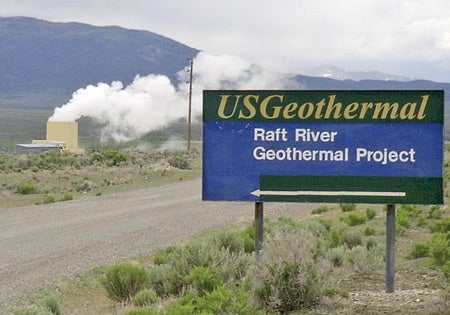

U.S. Geothermal Inc. (USG) is close to breaking that long dry spell with commercial operation of the first phase of its new and improved Raft River Geothermal Project. The plant is located in the Raft River region of southern Idaho, approximately 200 miles southeast of Boise (Figure 1).
1. Do you know the way? U.S. Geothermal bought the assets of the defunct DOE geothermal demonstration plant in Idaho, renovated the wells, and will have a new 13-MW plant on-line this year. Courtesy: U.S. Geothermal

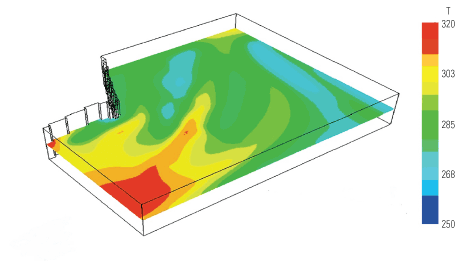

2. Deep impact. Raft River geothermal resources average around 280F and may hold enough energy to produce over 100 MW. The reservoir model found the field’s natural recharge capability is 405 gpm of 312F water. Courtesy: U.S. Geothermal
