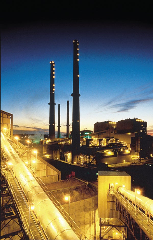

The Colstrip power plant, located east of Billings, is the second-largest coal-fired project west of the Mississippi. It comprises four coal-fired generating units capable of producing close to 2,100 MW. Units 1 and 2 began commercial operation in 1975 and 1976; Units 3 and 4 started in 1984 and 1986. Units 1 and 2 both have about 310 MW generating capacity. Units 3 and 4 have about 740 MWe net of generating capacity each (Figure 1).
1. High plains plant. The Colstrip plant is the second-largest coal-fired facility west of the Mississippi. It burns one rail car’s worth of coal every five minutes. Courtesy: PPL Corp.
The plant sits next to the Western Energy Co. Rosebud mine, a 25,000-acre surface mine complex in the northern Powder River Basin (PRB) near Colstrip, Mont., and the Northern Cheyenne Indian Reservation. Rosebud is a large operation with three active pits; it supplies almost all of its current production to Colstrip.
Although coal chemical composition is generally consistent from this expansive mine, coal mercury content varies substantially. Units 3 and 4 can go from 5 to 10 lb/TBtu Hg.
