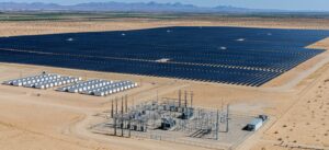

The California Energy Commission (CEC) has approved the Darden Clean Energy Project, which the agency said is the first to be fast-tracked under the group’s Opt-In Certification program. The commission said the installation features 1,150 MW, or 4,600 kWh, of battery energy storage, along with a 1,150-MW solar array with about 3.1-million panels.
Officials as part of their June 11 announcement about the project said the facility once complete will be the largest battery energy storage system in the world. The Opt-In Certification program, authorized under Assembly Bill 205, provides a consolidated state permitting option for eligible clean energy projects. California has a goal of 100% zero-carbon retail electric sales by 2045, as required by Senate Bill 100. As part of the statute, the environmental review for a project must be completed within 270 days from the point the project application is deemed complete, unless significant project changes arise that require more time to review.
“California is moving faster than ever before to build the clean energy we need, now with the world’s largest solar and battery project,” said California Gov. Gavin Newsom. “With a record amount of clean energy capacity added last year, we’re creating jobs and supporting local communities, all while building a cleaner, more reliable power grid.”
The Darden project will be built on 9,500 acres in western Fresno County, a site that officials said no longer is able to support agriculture. IP Darden I, LLC, a subsidiary of Intersect Power, owns the installation. Darden will connect to the Pacific Gas & Electric (PG&E) grid.
