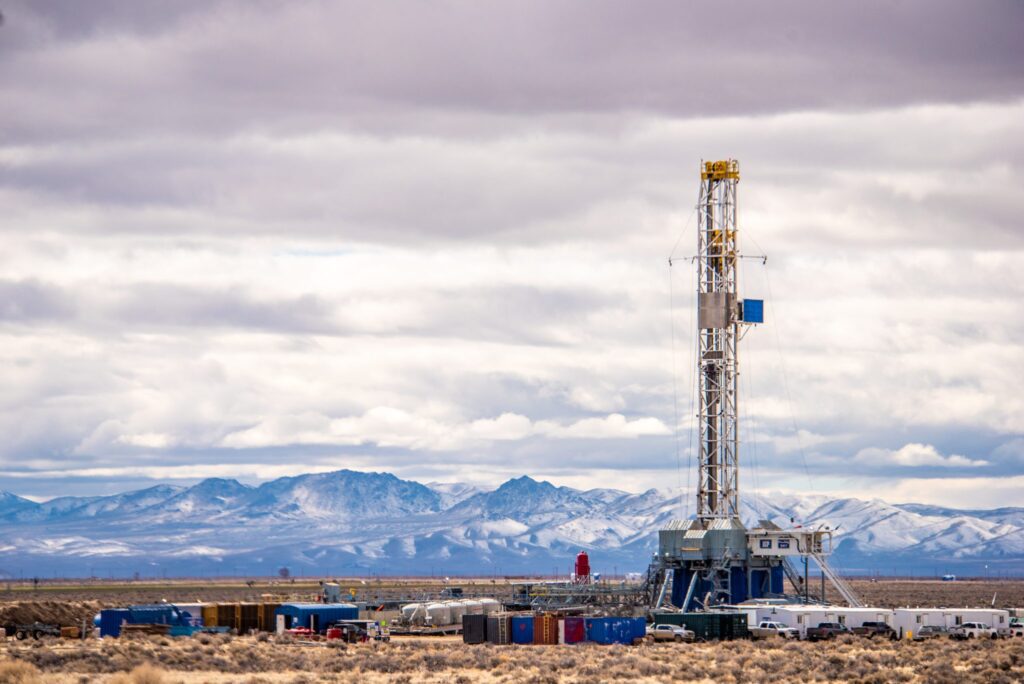

Fervo Energy announced the successful drilling and logging of its Sugarloaf appraisal well in southwest Utah, an operational achievement that the company said demonstrates the rapid advancement and scalability of enhanced geothermal systems (EGS). The well was drilled to a true vertical depth of 15,765 feet and is projected to reach a bottomhole temperature of 520F after full thermal equilibration. Houston, Texas-based Fervo, in announcing the successful project on June 10, said the Sugarloaf well was completed in just 16 drilling days, representing a 79% reduction in drilling time compared to the U.S. Department of Energy baseline for ultradeep geothermal wells.
While drilling what is Fervo’s hottest and deepest well to-date, the company was able to achieve multiple drilling performance records, including a maximum bit run length of 3,290 feet, a maximum average rate of penetration, or ROP, of 95 feet/hour, and an instantaneous ROP of more than 300 feet/hour at depths greater than 15,000 feet. These results expand the window for commercial viability of EGS into a significantly deeper and hotter regime, paving the way to deploy the technology outside of the western U.S.

Fervo Energy’s Cape Station geothermal development, which includes the Sugarloaf well, is located in Beaver County, Utah. Source: Fervo Energy
