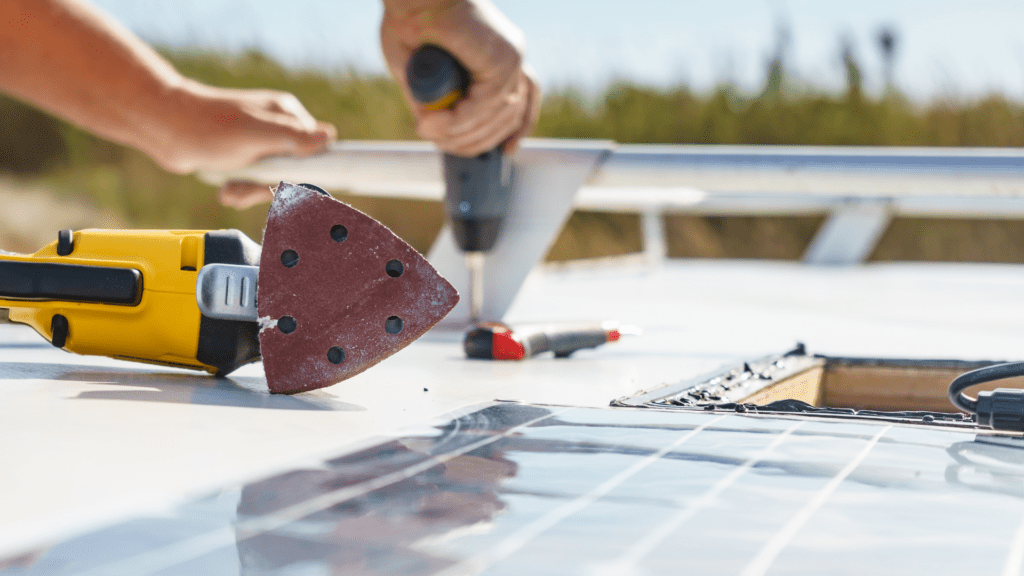

Hager: There are two significant components to the reliability of electrical systems. Design and maintenance. A system designed without regard to operation and maintenance will not be reliable. For example, a rooftop commercial solar design that maximizes output but leaves no room between rows will encourage maintenance technicians to walk on modules, thus shortening the system’s life. And the best-designed systems will not be reliable without regular maintenance (Figure 1). An example would be a central inverter in a solar field filled with dust because it was never taken offline to clean, which will not be reliable.

1. Professional installation and regular maintenance of solar power systems is critical to ensure they operate with optimal efficiency. Source: Canva / Engineering Design & Testing Corporation
