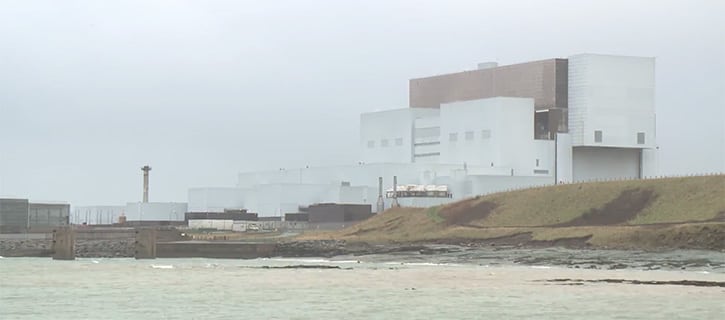

EDF Energy said that the Heysham reactor—a 615-MW unit located on the northwest coast of England near Lancaster—produced more than 14 TWh of electricity during its run. The unit was taken out of service for planned maintenance (Figure 1) and is expected to be offline for a little more than two months.
1. The Heysham 2 reactor in the UK set a new world record for continuous operation. Courtesy: EDF Energy

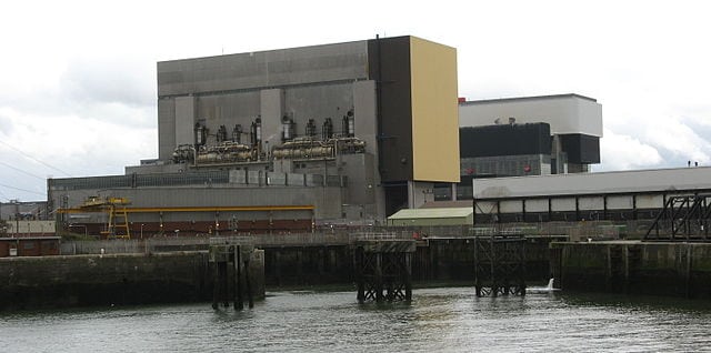

Earlier this year, EDF Energy extended the scheduled closure dates for four of its nuclear power stations. Heysham 2 (Figure 2) is now expected to remain in operation an additional seven years until 2030.
2. Heysham 2 opened in 1988. It is expected to remain in service until 2030. Courtesy: EDF Energy
