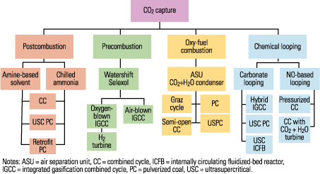

For plants currently in the planning or design stage, owners, EPC (engineering, procurement, and construction) contractors, and equipment suppliers are trying to determine which features need to be applied today to minimize the impact of future technologies on plant layout, performance, and operability. Given those circumstances, perhaps the best strategy for reducing a coal plant’s carbon footprint is to consider using several complementary methods simultaneously, rather than wait for a single “silver bullet” technology solution that may never be developed.
Part I of this article addresses the impact that various postcombustion carbon capture techniques have on a coal plant’s design, performance, and complement of equipment. Part II will explore a variety of non-postcombustion carbon capture and reduction methods. Unfortunately, cost comparisons of the various technologies and approaches (Figure 1) can not be included, due to the high volatility of labor, material, and equipment prices.
1. Available CO2 capture options. Source: Bechtel Power Corp.
