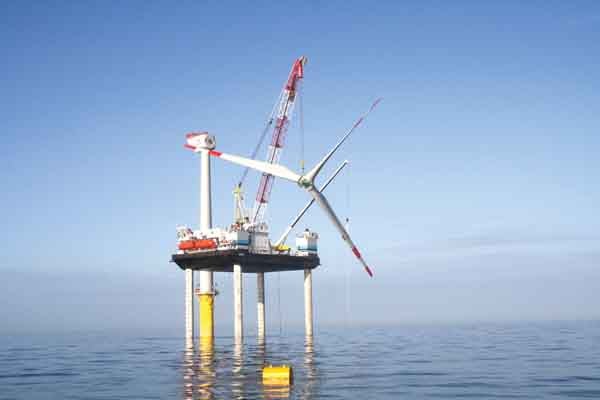

The first six of a dozen high-capacity turbines were commissioned in mid-December at the 60-MW Alpha Ventus project in the North Sea, Germany’s first offshore wind park. All 12 turbines of the €250 million project are already standing, put up in just seven months by a consortium of EWE, E.ON, and Vattenfall — formally known as Deutsche Offshore Testfeld und Infrastruktur (DOTI).
The construction of the 12 massive 5-MW wind turbines 45 kilometers (km) from the shore in waters 30 meters deep was a "remarkable logistical achievement," the DOTI companies said in a joint statement. It was far more complex than other wind parks because it involved building two types of German-manufactured wind turbines on two different types of foundations: six AREVA Multibrid 5-MW M5000 turbines, which came online in December, and six 5-MW Repower turbines. The turbines stand in a 4-km2 rectangle. The Multibrid turbines from AREVA rise 148 meters above the sea surface (Figure 3) while Repower’s turbine’s rise 155 meters high.
3.      Taking the plunge. AREVA, a wellknown nuclear brand, made its foray into the offshore wind sector when six 5-MW M5000 turbines manufactured by its German subsidiary Multibrid were installed and commissioned at the 60-MW Alpha Ventus wind park in the North Sea last December. Germany’s first offshore wind park also features six 5-MW REpower turbines. The 12 turbines stand in a 4–square kilometer rectangle 45 kilometers from the shore in waters 30 meters deep. Courtesy: AREVA
