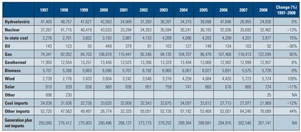

California’s historic energy mix. Biomass-fueled power generation has remained unchanged over the past 12 years. Electricity consumption is in MWh. Source: California Energy Commission
The entire biomass power plant fleet in California numbers around 50 and has a gross capacity of approximately 968 MW. These plants are typically solid-fueled combustion power plants and engines, boilers, and turbines operating on landfill gas, sewage digester gas, and biogas from animal manures. Another six projects totaling about 180 MW are advertising commercial operating dates in the last quarter of 2009, although four will burn municipal solid waste.
Of the 968 MW total, 136 MW is fueled by agricultural biomass, 262 MW by in-forest biomass and mill residues, and 570 MW by the biomass fraction of municipal wastes. Biomass projects operating at the end of 2008 supplied about 1.9% of the state’s electricity consumption needs, far short of Schwarzenegger’s 4% goal (20% of 20%) originally set for 2010. The odds don’t look good for meeting the biomass portion of the 2020 RPS goals.
The California biomass electricity market segment grew quickly in the 1980s, when more than half of the 50 biomass plants were constructed. These plants, representing about 625 MW, were constructed between 1983 and 1990 when lucrative power purchase agreements (PPAs) and production tax credits were available. The remaining third of the plants, those built since 1990, are generally smaller, and few use conventional solid-fuel combustion or selected municipal solid waste collection and combustion technologies.
