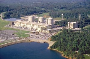

The Oconee Nuclear Station (Figure 1) is set in the northwestern corner of South Carolina, which is a land of waterfalls, cool pine forests, and rivers with fast rapids that are popular among whitewater rafters. Fittingly located not far from the Chattooga River, where the movie Deliverance was filmed, the plant for more than 36 years has successfully delivered more than 500 million MWh of electricity to its customers. According to Duke Energy, it is the first nuclear plant to achieve this milestone.
1.    Leading by example. Through the years, the Oconee Nuclear Station has excelled in providing safe, reliable energy. For example, it is the first U.S. nuclear plant to successfully deliver more than 500 million MWh of electricity to its customers. Courtesy: Duke Energy Corp.
