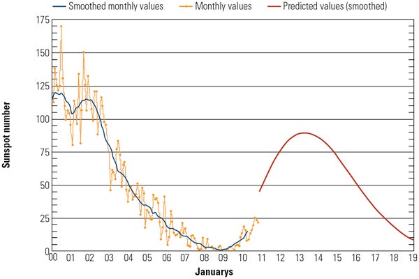

By many indications, our globe may be entering a period of greatly increased jeopardy from solar attacks. Solar activity, as astronomers have known for centuries, follows a roughly 11-year cycle, heralded by visible disturbances on the surface of the sun, known as sun spots (Figure 1). Sun spot activity shows that today the sun is at the end of a rather extended period of little activity, a “solar minimum.”
1. Stormy weather coming. The cyclical nature of the number of sunspots is predictive of the severity and number of expected solar storms—more sunspots mean more solar storms of increasing intensity. Data collected through November 2010 are shown, with predicted values in red. According to the Solar Cycle 24 Prediction Panel, the minimum of the current 11-year cycle occurred in December 2008. Source: NOAA
National Oceanic and Atmospheric Administration (NOAA) physicist Douglas Biesecker noted an increase in sunspot activity in early 2008, which he described “as like the first robin of spring. In this case, it’s an early omen of solar storms that will gradually increase over the next few years.”
