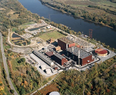

BEC (Figure 1) is located on the west bank of the Hudson River about 3 miles south of Albany. The plant has a 3 x 3 x 1 combined-cycle configuration: three GE 7FA combustion turbine-generators (CTGs) exhausting at 1,140F to three Nooter/Eriksen heat-recovery steam generators (HRSGs) whose outputs are combined to feed one GE D11 steam turbine-generator.
1. Sitting pretty. The new 750-MW Bethlehem Energy Center, on the west bank of the Hudson River. It replaces the 50-year-old Albany Steam Station—the faded brick building just west of the switchyard, which was reused. Courtesy: PSEG Power
