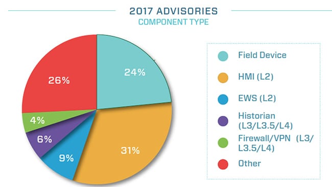

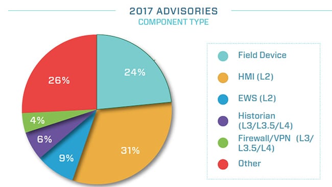

Another shortcoming is that industrial-focused advisories tend to focus predominantly on hardware and field devices, and not as much on network perimeter and entry points to ICS networks. “Nearly 66% of advisories cover human machine interface (HMI), engineering workstations (EWS), and field device components; historians, OPC servers, and analytics services all provide cross-domain access between corporate and ICS networks,” he said (Figure 1). However, mitigating vulnerabilities in these components does little to reduce overall risk, “because the components themselves are insecure by design.” A better approach would be to increase scrutiny on cross-domain devices and applications where research outcomes will lead to a stronger first layer of defense.
Figure 1_DragosVulnerabilities
  1. Vulnerable components. About 64% of the 2017 ICS-related vulnerabilities surveyed by cybersecurity firm Dragos in 2017 impacted interior control system components (HMI, EWS, or controllers), while 26% were reported in field devices (PLCs, RTUs, and other controllers that directly read and operate the physical process). The firm also found that the majority of 2017 vulnerabilities were sourced from hardware or software that was procured at costs—as opposed to in free or “demo” software. Courtesy: Dragos
