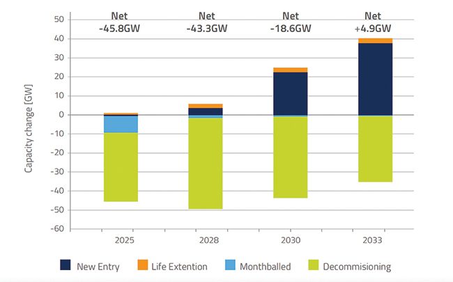

In a recent white paper, the trade group suggests the region’s flexibility needs will double by 2030 as the region grapples with a surge in demand stemming from increased electrification in households, industry, and mobility. “The daily flexibility need alone is expected to grow by 209 Terawatt-hour (TWh) from 2021—equivalent to adding the yearly electricity consumption of a small European country,” it said. “Looking to 2050, the total requirement for flexibility (daily+weekly+monthly) will have a dramatic fivefold increase,” it predicted. “According to the European Network of Transmission System Operators for Gas (ENTSO-G), the flexibility in energy to support the aforementioned changes is projected to increase by 40%–65% by 2050,” it said. ENTSO-Electricity, notably, forecasts a net decrease of 107 GW in flexible generation capacity, primarily from dispatchable thermal turbines, by 2030 (Figure 1).
1. According to the European Network of Transmission System Operators for Electricity (ENTSO-E), Europe’s existing flexible generation capacity is currently dominated by dispatchable thermal turbines. Thermal turbine capacity, however, is slated to decrease starting this year, mainly owing to economic reasons. Courtesy: ETN
