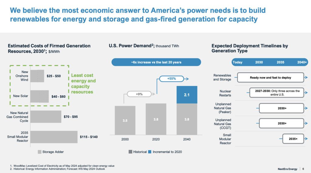

This slide from NextEra Energy's Jan. 24, 2025, earnings presentation outlines its cost-effective strategy: pairing renewables and storage for energy with gas-fired generation for capacity. While renewables can be deployed quickly, natural gas and nuclear face longer timelines, with only three SMRs expected nationwide by 2030. Source: NextEra Energy Fourth Year and Full Year 2024 Earning Conference Call
This slide from NextEra Energy’s Jan. 24, 2025, earnings presentation outlines its cost-effective strategy: pairing renewables and storage for energy with gas-fired generation for capacity. While renewables can be deployed quickly, natural gas and nuclear face longer timelines, with only three SMRs expected nationwide by 2030. Source: NextEra Energy Fourth Year and Full Year 2024 Earning Conference Call
