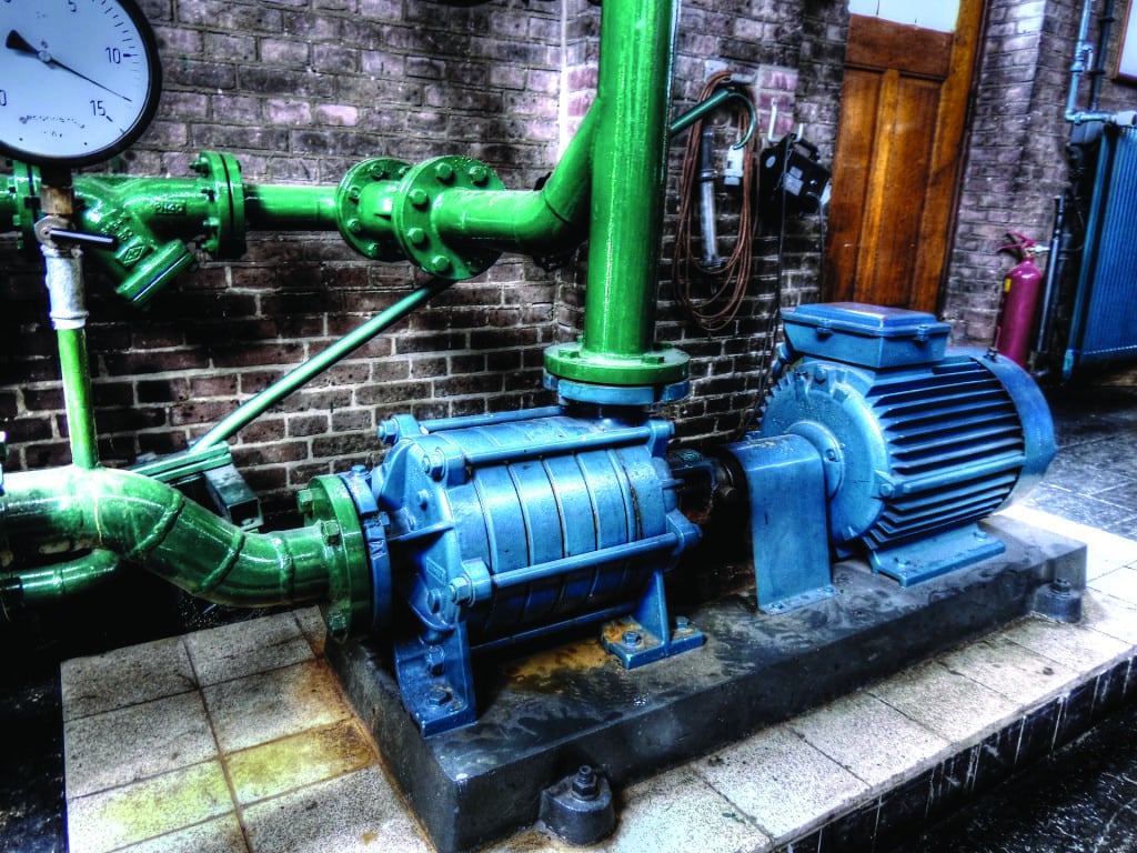

The original design of Progress Energy’s Lee Plant in Goldsboro, N.C., enlisted nine vertical sump pumps within the plant yard as drain pumps. In this type of design (Figure 1), the motor is at the top of a shaft that extends down to the bottom of the sump, where the pump itself is located. At the Lee plant, the vertical pumps remove all kinds of water: standing accumulations of rainfall, coal pile runoff, and water from storm drains from equipment washdowns. The pumps’ outputs are piped to a retention settlement basin whose sumps are below grade.
1. Problematic pumps. Vertical sump pumps played an important role at Progress Energy’s Lee Plant: keeping the plant yard properly drained. But as they aged, the pumps became less reliable and more expensive to maintain. Gorman-Rupp horizontal self-priming centrifugal pumps were selected as a replacement. Courtesy: Gorman-Rupp
As the pumps aged, their maintenance became more frequent and more expensive. Several years ago, their reliability had deteriorated to the point of compromising overall plant operations. "We were rebuilding those nine vertical line sump pumps on a regular basis," said Ed Davis, a senior work management specialist with Progress Energy. Replacing the pumps became a matter of "when," rather than "if."
Opportunity knocks
About four years ago, Davis consulted Bill Lynch of Tencarva Machinery Co. (www.tencarva.com), an employee-owned firm that specializes in rotating equipment and wastewater pumps for industries such as power generation.
After further discussions with Lynch at the plant, Davis decided to replace the vertical line sump pumps by horizontal, self-priming, centrifugal pumps. In addition to being more efficient, the centrifugal pumps are easier to maintain because they can be installed above ground level at the top of the pumping station, with only a suction line submerged below grade.
Ultimately, Davis specified Gorman-Rupp’s (www.gormanrupp.com) Super-T pumps in three sizes: 4, 6, and 8 inches. "When we compared the cost of the new pumps to the cost of maintaining the old ones, we felt the savings justified investing in new motor skids and controls as well," said Davis.
Before making a final decision to replace all nine vertical sump pumps, Progress bought two of the Gorman-Rupp centrifugal pumps on a trial basis and installed them over the course of 18 months. "To make sure we’d be making a sound investment, we wanted to spend time observing the pumps closely," Davis said. According to Tencarva’s Lynch, it took teams of two or three men about two weeks to make the switch, including piping and electrical modifications.
A thumbs-up trial
After seeing the centrifugal pumps work as advertised, Progress Energy ordered seven more. All nine vertical sump pumps have now been replaced, and seven of the new Super-T Series pumps (Figure 2) have assumed responsibility for keeping the plant yard drained. "Tencarva did an excellent job of matching the new equipment to our existing structure," said Davis. "The switch was completed easily and efficiently."
2. Prime numbers. Super-T centrifugal pumps can reprime automatically in a completely open system without the need for suction or discharge check valves. They can even do so when the pump casing is only partially filled with liquid and the suction line is dry. Courtesy: Gorman-Rupp
“Every 12 to 18 months, we had to rebuild a pump at each pump station,” said Davis. “We’ve operated the centrifugal pumps for three years now, and we have only had to perform normal preventive maintenance on them.”
According to Tencarva, Progress Energy has experienced only minor pump maintenance issues over the past three years. "With nine units, they [had to open] one of them up at least once a year, and that added up," said Lynch. "With the new pumps, the only problem was an air release valve that leaked and had to be replaced. The plant will soon need to replace three or four of the remaining pumps on its grounds. But the key is that when they wear out, the Lee plant doesn’t plan to rebuild them. They plan to match up the pump size and replace the vertical line sump pumps with self-priming centrifugal pumps. I think the pumps’ track record speaks for itself."
