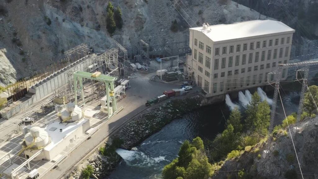

PGE has embarked on a modernization program to revitalize the reliability, performance, and environmental quality of its hydropower plants, some of its oldest assets. Modernization efforts have improved the efficiency, reliability, and operational safety of the historic Faraday Powerhouse, a 116-year-old plant located on the Clackamas River in Estacada, Oregon. The project in September 2024 received $5 million under the Department of Energy’s Maintaining and Enhancing Hydroelectricity Incentives program. Courtesy: PGE
