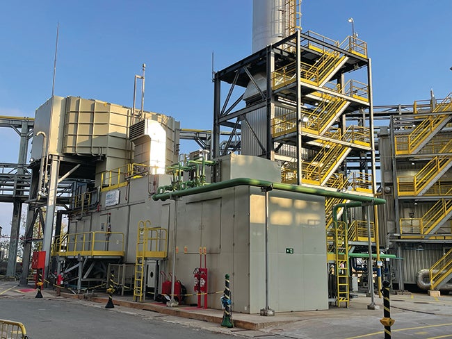

Siemens Energy was responsible for implementation of the project, and for operating the electric and steam cogeneration plant for an initial term of 15 years. As part of the contract, Siemens agreed to implement a fully integrated and redundant equipment solution, including two SGT-600 gas turbines, an E-house (that is, a ready-made electrical building that houses all the necessary power distribution and control equipment), as well as an extension of the existing high-voltage substation, three reciprocating compressors, an advanced load-shedding system, and associated software for plant control. The plant’s state-of-the-art technology solutions combined high energy efficiency and extreme operational reliability with low emissions. These elements were part of an energy-as-a-service concept, meaning Braskem receives the energy without having to invest in, build, and operate the plant on its own.

The maximum power output of an SGT-600 turbine is 24 MW. For this application, each turbine provides 19 MW of power continuously and 80 tons per hour of steam to the petrochemical complex through its heat recovery steam unit (HRSU). In addition, the gas turbines feature third-generation dry-low-emissions (DLE) technology. The DLE technology reduces CO 2 emissions, and NO x levels from the turbines are low at just 25 parts per million (ppm). A load-shedding system ensures safe operation of the plant by managing all loads depending on the available power supply.
“The third-generation DLE combustion technology has been developed and validated ahead of the release in the Vesta project for hydrogen levels up to 80%,” Mendes reported. “Only minor adjustments in the control system were needed to handle the sometimes fast and high variations in the hydrogen content during disturbances in the fuel gas supply.”
