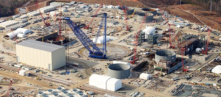

According to Steve Byrne, COO of South Carolina Electric and Gas Co. (SCE&G), 85% of the major equipment necessary to build V.C. Summer Units 2 and 3 is onsite, and of the remaining components, a lot of them are physically constructed waiting to be transported or are already loaded on ships headed to South Carolina.
The estimate, along with a detailed update on construction progress, was provided during a conference call held on February 18.
To start things off, Byrne noted that Westinghouse had completed its deal with CB&I, acquiring Stone & Webster at the end of last year. He also said that Fluor Corp. began working as a subcontracted construction manager at the nuclear construction site near Jenkinsville on January 4.
