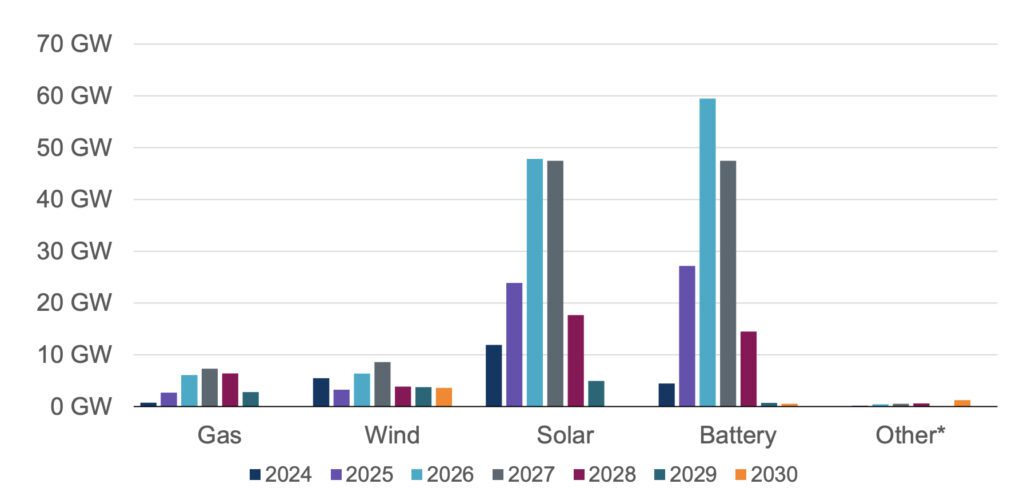

ERCOT is tracking 1,881 active generation interconnection requests totaling 371,689 MW as of September 30, 2024. Solar and battery projects dominate the queue, each accounting for over 41% of the total capacity (153,658 MW and 154,264 MW, respectively), followed by wind (34,839 MW, 9.4%) and gas (25,967 MW, 7%). Inactive projects increased to 103, up from 99 in August. Source: ERCOT Monthly Operational Overview, October 17, 2024.
ERCOT is tracking 1,881 active generation interconnection requests totaling 371,689 MW as of Sept. 30, 2024. Solar and battery projects dominate the queue, each accounting for over 41% of the total capacity (153,658 MW and 154,264 MW, respectively), followed by wind (34,839 MW, 9.4%) and gas (25,967 MW, 7%). Inactive projects increased to 103, up from 99 in August. Source: ERCOT Monthly Operational Overview, October 17, 2024.
