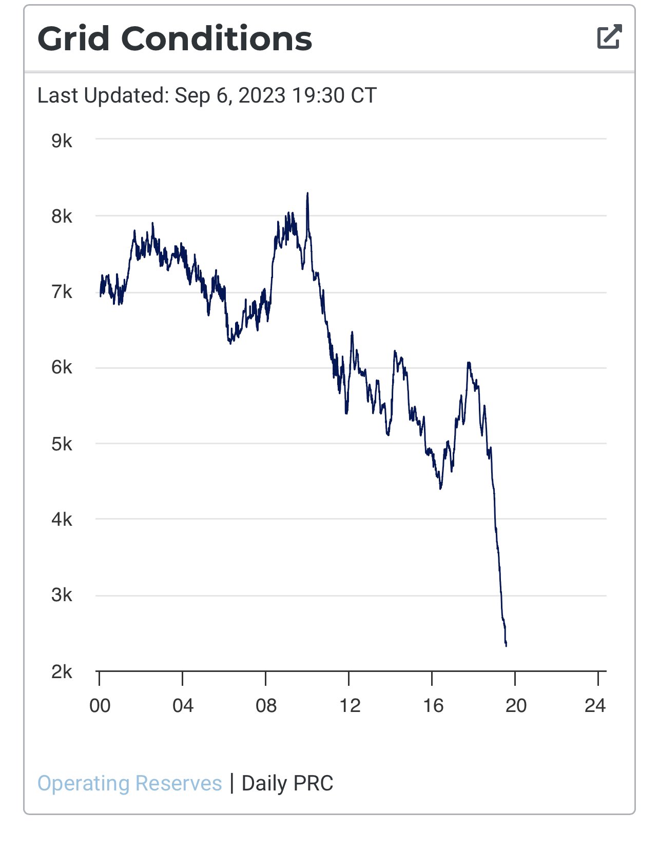

An EEA declaration initiates an orderly and predetermined procedure for maximizing the use of available resources on the grid, including voluntary load reduction programs that are only available under EEA operations. An EEA 2 is typically issued when ERCOT’s operating reserves have dropped below 1,750 MW and are not expected to recover within 30 minutes. ERCOT’s EEA 2 declaration at sunset notably bypassed the grid operation’s declaration of an EEA 1, which is issued when ERCOT’s operating reserves fall below 2,300 MW. On Wednesday, ERCOT’s website suggested the grid had operating reserves of 2,388 MW when it declared the Level 2 alert.
ERCOT’s operating reserves began a steep decline at around 7  p.m., spurring a frequency drop, which prompted the grid operator to declare an Energy Emergency Alert 2 (EEA 2). Source: ERCOT

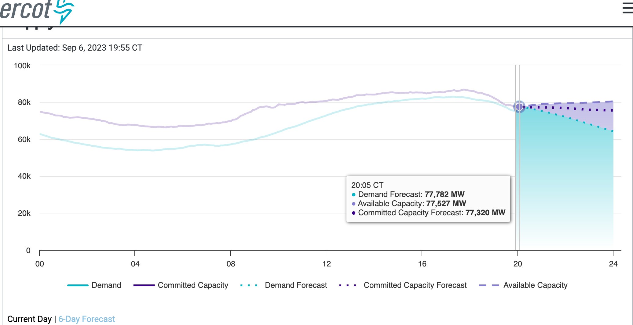

ERCOT’s dashboards illustrated its efforts to keep delicate grid conditions balanced during the emergency conditions. At around 8 p.m., its Supply and Demand dashboard forecasted precarious conditions in which available capacity barely exceeded its forecasted demand. At one point, the dashboard suggested demand would outweigh supply.
Top: A snapshot of ERCOT’s Supply and Demand dashboard on the evening of Sept. 6 shows that at one point (8:05 p.m.), demand was forecasted to exceed available capacity by 255 MW and committed capacity by 462 MW. Bottom: ERCOT’s data of how supply and demand actually panned out. Source: ERCOT
