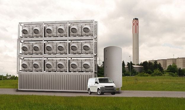

 Figure 3- Climeworks technology to draw in ambient air and capture Co2 with patented filter
1. The DAC module. Climeworks has installed a direct air capture (DAC) module at the Hellisheidi plant in Iceland as part of the CarbFix2 project led by Reykjavik Energy. The plant in Iceland first began using carbon capture technology in 2007, and CarbFix researchers recently showed that the Climeworks system could be viable as a carbon capture technology. Courtesy: Climeworks
Climeworks has developed a DAC module, installed at the site (Figure 1) and designed to be heated with low-grade heat from the geothermal plant, which captures gas in a Climeworks-designed filtration system. In the trial, researchers have injected CO2 at an industrial scale. The captured CO2 is bound to water, and then sent more than 700 meters underground, where it reacts with basaltic bedrock to form solid minerals (Figure 2). The company said the gas would remain stored for at least 1 million years.
