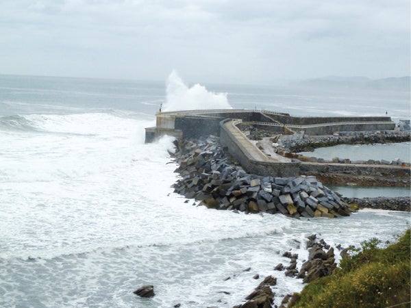

One of the world’s first breakwater wave power stations was commissioned this July by Ente Vasco de Energia (EVE), an energy agency in the northern Basque region of Spain. The €2.3 million ($3.3 million) project in Mutriku uses oscillating water column technology developed by Voith Hydro’s Wavegen, based in Inverness, Scotland. The technology is integrated into a concrete power station built on a breakwater or coastal protection project (Figure 6).
6. A breakwater breakthrough. Spanish agency Ente Vasco de Energia in July commissioned a 296-kW breakwater wave power station based on oscillating water column technology that uses 16 Wells turbines. The plant produces power by harnessing pressure differentials created by wave oscillations and converting that rotational energy into power. Courtesy: Voith Hydro
Essentially, waves create oscillations on the water’s surface in a partially submerged hollow chamber that’s open at the bottom. The oscillations continuously compress and decompress an air column above the chamber. The difference in pressure converts the rotational energy to electricity via a turbine-driven generator. The 296-kW offshore installation at Mutriku has 16 Wells turbines—a fixed-pitch machine with only one direction of rotation. As Voith Hydro notes, “therefore, the rotor is symmetric with respect to the rotation plane.”
