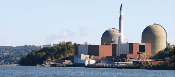

The U.S. Nuclear Regulatory Commission (NRC) in October directed staff to begin implementing seven safety recommendations put forth by the federal body’s Near-Term Task Force on lessons learned from the nuclear accident at Tokyo Electric Power Co.’s Daiichi power plant in Japan’s Fukushima prefecture last March. The recommendations affecting all 104 nuclear reactors (Figure 3) in the U.S. could be in place by April 2014, but experts have urged that implementation of the rules be expedited.
3. Lessons learned. The Nuclear Regulatory Commission (NRC) will begin implementing at all 104 U.S. reactors recommendations made by a task force that was commissioned to identify lessons learned from the Fukushima nuclear accident in Japan. The accident has renewed NRC scrutiny and public pushback against older plants like Indian Point (shown here) in Winchester County, N.Y. Courtesy: Entergy
