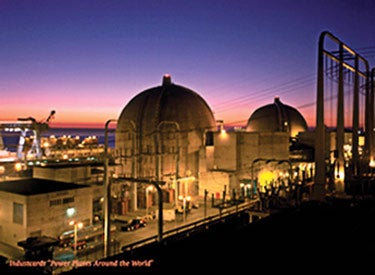

The San Onofre Nuclear Generating Station (SONGS) in northern San Diego County has one of the most beautiful locations of any power plant in the world (Figure 1). The plant, which is 75% owned and operated by Southern California Edison (SCE), consists of two nearly identical pressurized-water reactors rated at about 1,170 MW each. Units 2 and 3 (Unit 1 was mothballed in 1992) went on-line in 1983 and 1984. When the 1,800-rpm turbine-generator (TG) sets fed by the reactors’ steam generators were ordered from GEC (now Alston Power) in the late 1970s, they represented the largest nuclear prime movers ever built by the company.
1. Beautiful music. The San Onofre Nuclear Generating Station (SONGS) abuts the Pacific Ocean in northern San Diego County. Courtesy: Southern California Edison
