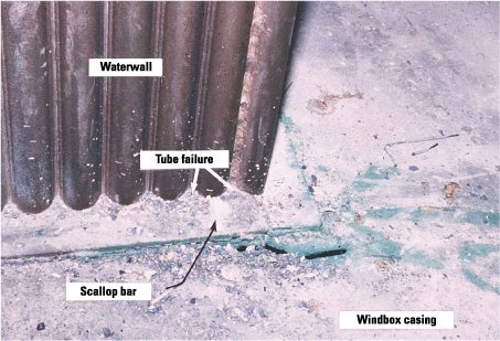

Cracking (particularly in membrane waterwall tubing) presents a challenge for conventional nondestructive evaluation (NDE) because the condition manifests itself as multiple cracks that initiate and grow on the inside surface of the tubes and on the insulated side of the tube—locations not usually accessible due to the presence of insulation, building structural components, and exterior building covering.
A typical location that may experience corrosion fatigue is shown in Figure 1. Notice the presence of the scallop bar and casing structure, which limits the use of conventional NDE, either ultrasonic or radiographic. The outer building structure (not shown in Figure 1) is farther from the waterwall tubes.
1. Tough spot. Here is one location where corrosion fatigue failures can occur on boiler waterwall tubes. Courtesy: EPRI
