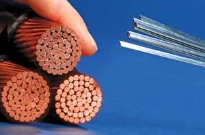

A power cable made with HTS wire inside can conduct up to 10 times the amount of power of the same-diameter cable made with copper wire (Figure 2). By replacing copper cables with high-capacity superconductor cables in cities using existing underground tunnels and ductwork, utilities can avoid digging up city streets while also relieving grid congestion and increasing the reliability and security of power networks. AMSC’s 344 superconductors, which piloted in 2007, feature a proprietary wide strip approach, which the company says reduces manufacturing costs.
2. South Korea’s superconducting cable. South Korea is gearing up to install the world’s longest distribution voltage superconductor system near Seoul by mid-2010. The system will use American Superconductor Corp.’s second-generation high-temperature superconductor wire (right), which conducts more than 150 times the electrical current of copper wire of the same size. The South Korean cable system will be will be nearly half a mile in length and be capable of carrying 50 MW of power. Courtesy: American Superconductor
