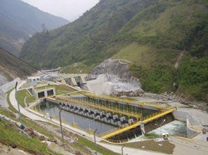

The 130-MW Yuncán  hydroelectric plant (Figure 4) has come online in Peru about 210 miles northeast of Lima. To show his support for the project, Peruvian President Alejandro Toledo Manrique attended the inauguration ceremony. Yuncán  was commissioned just 21 months after the Peruvian government awarded a 30-year contract to operate the plant to EnerSur, the Lima-based subsidiary of Brussels-based Suez Energy International. Peru's state-owned utility, Egecen S.A., built the facility.
Courtesy: Suez Energy International
4. Peru's new power plant. The 130-MW Yuncán hydroelectric power plant high in the Peruvian Andes is the country's newest generator.
Yuncán , which is powered by the Paucartambo and Huachon Rivers, has a catchment area of about 500 square miles and a 678,000-square-foot reservoir. The plant has two intake dams (one floating and one concrete-gravity) and an 18-mile waterway. The control center, which also houses three 44.5-MW generators from Toshiba, is underground. But Paris-based Alstom installed the generators and other electrical equipment. VA Tech Escher Wyss (Ravensburg, Germany) supplied the plant's three vertical-shaft, single-runner, four-nozzle, Pelton turbines, along with the injector pipes and protection. As part of the project, 30 miles of new 220-kV transmission lines and several substations were built between Yuncán and Carhuamayo to connect to the national grid.
