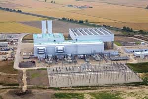

1. A bumper crop. An aerial view of the E.ON combined-cycle plant at Livorno Ferraris, Italy, which is located amid rice fields. The plant, which has an installed capacity of 800 MW and an efficiency of 57%, is capable of providing over a million households with an economical supply of eco-friendly electricity. Courtesy: E.ON
