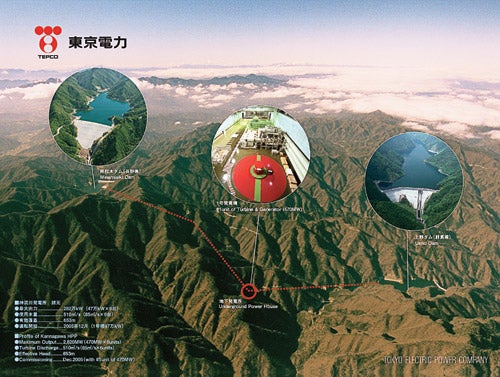

TEPCO’s Kannagawa Hydropower Plant (KHP), which is now about half-finished, is a "pure" pumped-storage plant; that is, water is pumped from a lower reservoir to a higher one during off-peak hours and released when there is an immediate need for power. What Figure 1 doesn’t quantify is that the water tunnel (the red dotted line) connecting the lower and upper reservoirs—created by the Minamiaiki Dam and Ueno Dam, respectively—is 3.8 miles long and spans two different prefectures. What it does illustrate are the number and size of the turbines envisioned—six, rated at 470 MW apiece (Figure 2). The power house in which the turbines "live" was built in a large cavern 708 ft long, 108 ft wide, and 169 ft high, at a depth of about 1,600 ft.
1. Major water works. At 2,820 MW, the Kannagawa Hydropower Plant will be the world’s largest pure pumped-storage plant when all six of its units are completed—in 2016 at the earliest. Unit 1 entered commercial service in December 2005. Courtesy: Tokyo Electric Power Company Inc. All rights reserved.

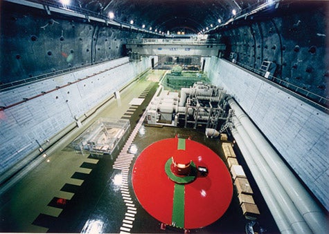

2. Cave dwellers. The turbine floor is 1,600 feet below the surface, in a cavern hewn from rock. Courtesy: Tokyo Electric Power Company Inc. All rights reserved.
