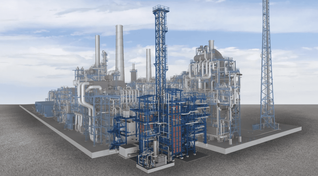

This is a rendering of the demonstration plant for large-scale electrically heated steam-cracker furnaces, located at a BASF site in Germany. The plant can potentially reduce at least 90% of the CO2 emissions emitted by common technologies. Source: BASF
The companies said two furnaces together will be able to process about four tons of hydrocarbon feedstock hourly, and consume 6 MW of energy from renewable resources.
