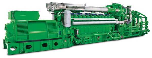

GE launched what it is calling the world’s first two-stage turbocharged gas engine this June. The new technology is initially being applied to its Jenbacher J624 engine (Figure 6), essentially upgrading the 24-cylinder gas engine GE introduced in 2007 for commercial power generation, but the company plans to offer it with other engines.
6. The little engine that could. GE launched “the world’s first” two-stage turbocharged gas engine, and it is initially applying the technology to its Jenbacher J624 engine (shown here). The company claims that an advanced boost pressure increases the 24-cyclinder gas engine’s output by nearly 10%—from 4 MW to 4.4 MW—and its electrical efficiency to 46.5%. Courtesy: GE
