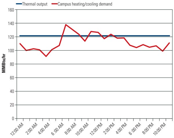

1. Winter thermal load profile. During demand peaks (circled area), the campus sheds load or uses its existing conventional boilers to produce steam. When demand falls below baseload (the shaded area), the plant uses the excess steam to produce extra power. Source: UCSD

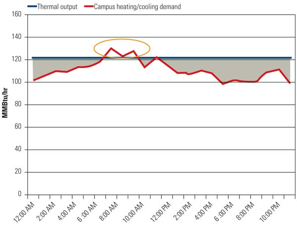

2. Summer thermal load profile. Water for cooling is chilled and stored during evening hours, when the thermal load is lowest. Source: UCSD

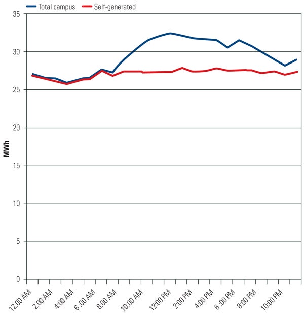

3. Winter electrical load profile. Though the campus cogen system can supply about 85% of electrical demand annually, it purchases power to meet peak demand periods in both summer and winter. Source: UCSD

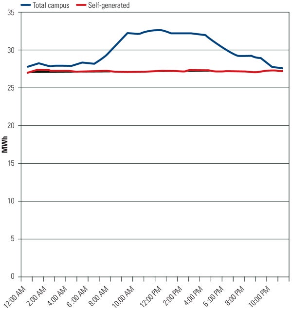

4. Summer electrical load profile. Source: UCSD
