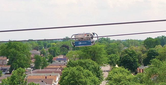

The first is treating overhead conductors with a heat-dissipating coating. This coating prevents the sun’s heat from penetrating the cable, while also allowing heat within the cable to emit, keeping the cable cooler. As we know, when a cable gets hot, it sags and droops, restricting the amount of energy that can flow through it.
2. A heat-dissipating coating can be applied to overhead line conductors. The coating prevents the sun’s heat from penetrating the cable, and allows heat within the cable to emit, keeping the cable cooler. When a cable gets hot, it sags and droops, restricting the amount of energy that can flow through it and perhaps creating a safety hazard. Prysmian has developed its E3X Robot System, shown here, which can apply the coating to existing wires in the field. Courtesy: Prysmian Group
This coating is applied to replacement cables as they are manufactured, providing newer, better wires for existing overhead structures. If the cable still has usable life remaining, Prysmian is even having success with a robot applying the coating in the field on existing wires to reduce power grid congestion, winning an Edison Award for its E3X Robot System (Figure 2) in 2022.
