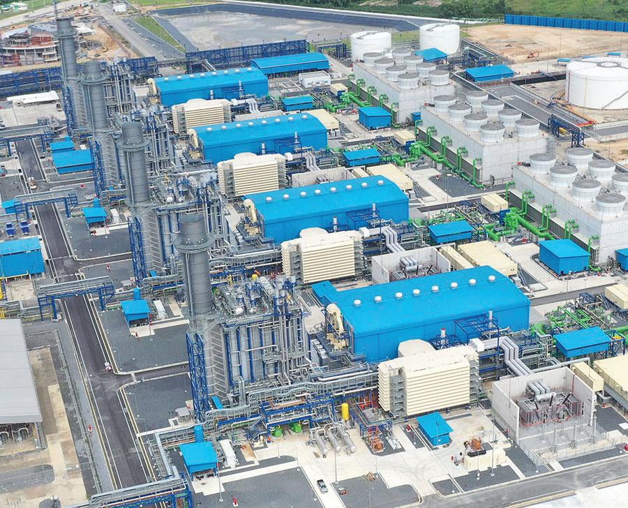

1. The gas turbine combined cycle power plant in Rayong. Courtesy: Mitsubishi Power
Meanwhile, lessons learned from the earlier-completed Chonburi site were integrated into the Rayong development (Figure 1), enabling smoother installation workflows and faster delivery. “There was a one-team mindset among everyone involved in the project, which was critical for smooth project execution,” Mitsubishi Power reported. In the end, the project was completed on schedule through strong coordination among the teams.
