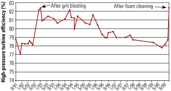

2. Copper costs. Copper plating on the HP turbine caused a long-term efficiency loss that was completely restored by foam cleaning. Source: Aquilex HydroChem

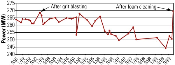

3. Lost capacity restored. The power output of the same steam turbine was restored after a foam cleaning. Source: Aquilex HydroChem

The results from an HP turbine cleaning are immediately obvious when the steam turbine is returned to service. Performance tests are often conducted before and after cleaning to demonstrate the value of the process. Figure 2 illustrates the efficiency lost due to copper plating of the HP turbine subsequent to a major overhaul outage during which the HP turbine blades were grit blasted. Note how the turbine efficiency gradually dropped over a period of seven years until the turbine was foam cleaned, and performance was restored. A similar trend is found with capacity lost over time (Figure 3).
