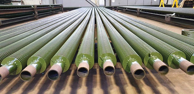

In high-temperature heat recovery systems, protective coatings are often expected to do two things that do not naturally coexist: resist aggressive chemical environments while maintaining efficient heat transfer. This tension becomes particularly acute in economizers handling exhaust gases and cooling water streams, where corrosion, fouling, and thermal stress act simultaneously on complex geometries. Säkaphen, a German manufacturer of protective coatings, may have found the right answer: phenolic-based chemistry (Figure 1).
1. Heat exchanger tubes with a phenalic-based coating applied. Courtesy: Säkaphen

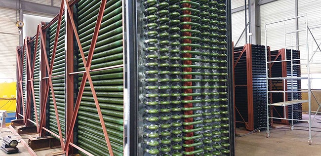

Säkaphen, supported by its authorized applicator Säkaphen Korea, offered something different: a two-product solution built around phenolic chemistry.
2. Spiral fin tubes with a phenalic-based coating applied. Courtesy: Säkaphen
The primary lining was Si 14 E, a single-component phenolic-based thermosetting coating (Figure 2). Phenolic resins form dense, tightly cross-linked films with very low permeability, making them ideal in chemically aggressive service.
“This formulation,” Fischer-Zernin noted, “resists a broad spectrum of substances: acidic condensates, salts, hydrocarbons, and all water types. Equally important, it has strong hydrophobic properties, reducing fouling, scaling, and particulate adhesion, all of which can impair both corrosion resistance and heat transfer in economizer service.”
The coating handles temperature swings from –20C to +200C without cracking, and unlike PTFE, it does not meaningfully impede heat transfer.

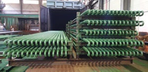

3. Coated economizer tubes after assembly of the bundle. Courtesy: Säkaphen
The second product, HR 60 Extra G, is a two-pack epoxy formulated for direct-to-metal application. It served as a complementary repair and touch-up coating, fully compatible with Si 14 E, and was also specified to protect the welds joining the spiral tubes to form complete cooler assemblies (Figure 3). Before a gram was applied in South Korea, the system was tested as per the client’s requirements at Säkaphen’s headquarters in Gladbeck. It passed, and the first job went ahead.
Early Challenges in the Field
The first application of Si 14 E proceeded smoothly. At that point, however, construction reality intervened: minor surface damage and localized corrosion caused by the accidental omission of PTFE sleeves during tube installation and by prolonged outdoor storage were promptly addressed on-site with HR 60 Extra G. Its dual approval proved its value here: damaged and exposed areas were cleaned and recoated in the field without requiring any additional qualification or product substitution.
When a formal inspection was carried out in 2022, the results were telling. In the few areas where paint loss had exposed the base metal, the steel itself showed minimal corrosion. “This told us the coating had done its job up to the point of failure,” Fischer-Zernin said.
Once again, repair proved straightforward: affected sections were cleaned with sandpaper and wire brushing, then recoated with HR 60 Extra G by airless spray. The sections repaired during the original construction phase validated the method conclusively: those areas showed no subsequent corrosion at the 2022 inspection.
