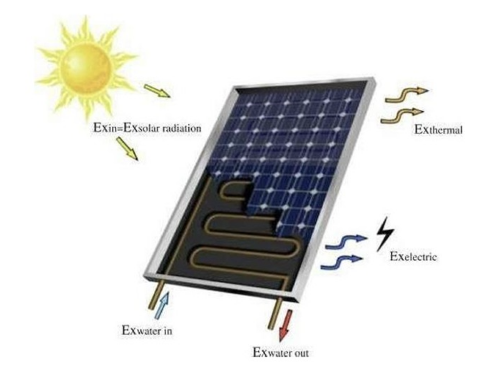

1. Active cooling systems allow for a more efficient conversion of sunlight into electrical energy, improving the overall performance of the solar cells. Courtesy: Yousef Al-Manzalawi, Mechanical Engineering Department, Taibah University
In PV systems, the increased temperature due to excessive heat build-up can lead to a reduction in efficiency and damage to the materials. Thus, active cooling systems are employed to reduce the temperature of the PV cells, ensuring that more energy is converted into electricity rather than being lost as heat. Active cooling systems such as liquid cooling, forced air cooling, and thermoelectric cooling are designed to reduce Q out —the heat energy rejected or lost from a system—by enhancing heat dissipation, thereby lowering the temperature of the module. These systems (Figure 1) allow for a more efficient conversion of sunlight into electrical energy, improving the overall performance of the solar cells.

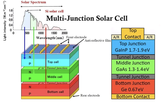

Active cooling systems are critical for maintaining optimal operating temperatures in high-efficiency PV cells, especially for advanced technologies like triple-junction cells (Figure 2). The following paragraphs examine key active cooling approaches and their mechanisms for optimizing cell operating temperatures.
2. This image details the inner workings of a multi-junction solar cell, in this case a triple-junction cell. Courtesy: Yousef Al-Manzalawi, Mechanical Engineering Department, Taibah University
