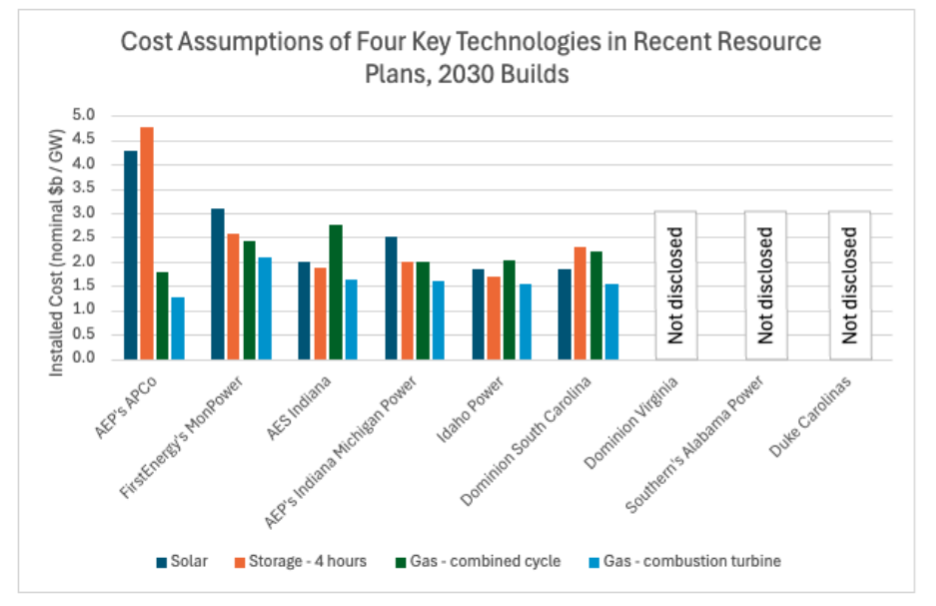

One of the most important pieces of information to take into account is the cost assumptions used to determine what resources to build. Surprisingly, companies are using a lot of discretion with respect to how much it costs to build different resources. The chart below summarizes the cost assumptions used in several notable plans filed in 2025 for a 2030 build.
(Note: Companies disclose in a variety of formats, and we have converted into nominal dollars and total installed costs where necessary for comparability.)
The fact that Duke Carolinas and Dominion Virginia did not disclose their cost assumptions in 2025 is surprising, since they did in their prior plans, and Duke’s and Dominion’s other subsidiaries are disclosing those costs. Alabama Power’s lack of transparency is unsurprising since Southern takes the same approach with its other subsidiaries, Georgia Power and Mississippi Power. Fortunately, most companies are still transparent, but the list of companies not disclosing this information to the public and investors is growing.
AEP’s Appalachian Power Co’s assumptions stand out as being wildly inflated for clean energy, and low for new gas builds. The company states these costs are “informed from the 2024 Renewable RFP,” but we wonder if AEP’s clean energy cost assumptions are distorted by unusually high, nonserious bids from developers.
With all the federal policy changes, including tariff uncertainty, and other inflationary pressures in the construction sector, determining appropriate build cost assumptions is getting harder. Public sources like NREL’s Annual Technology Baseline are lagged, and up-to-date estimates are paywalled. As a result, comparisons across peers are still worthwhile, if one pays close attention to when a plan is filed.
Importantly, inflation has not just been limited to solar, wind, or energy storage. Cost increases have actually impacted gas plant builds more, with estimated costs of $2.8 billion per GW to build a combined-cycle plant.
Given these discrepancies and their potential impact on shareholders and consumers, the first step is for utilities to disclose these cost assumptions in their IRPs. Ideally, these disclosures should show the assumptions for the full planning horizon and not just a single year. Utilities should also model into their assessment moderate cost declines for solar and energy storage, since installation becomes more efficient and supply chains mature. IRPs are forward looking, often with a horizon of two decades, so it does not make sense just to use today’s costs.
