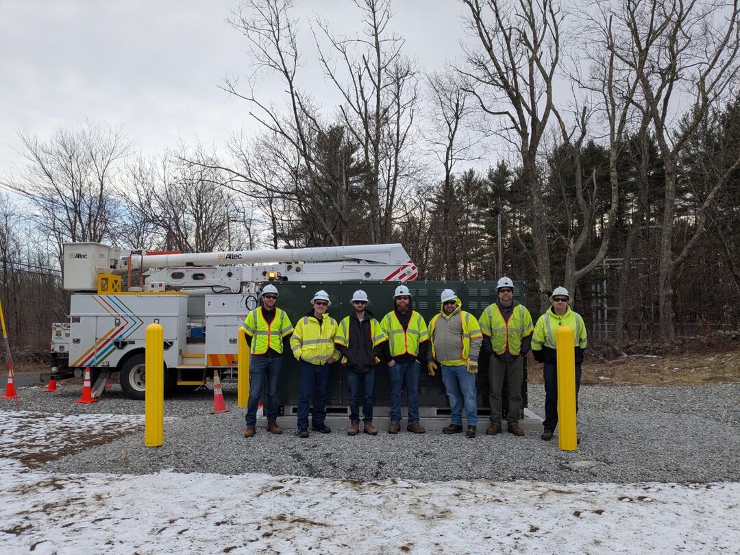

The technology is now deployed across New York, Alaska, Florida, Georgia, Iowa, Massachusetts (Figure 2), Texas, and Washington state. A recent Georgia Power deployment is designed to reduce load imbalance by half and voltage imbalance by more than 30%, with the utility providing substation-level data to track performance.
Massachusetts-Deployment-Switched-Source
2. Workers involved in a Massachusetts project. Courtesy: Switched Source
