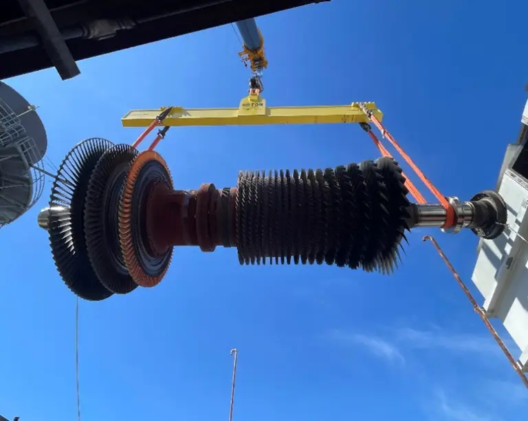

A customer-supplied, refurbished gas turbine rotor would be installed after MD&A inspection.
MD&A Motor Removal
Rotor Removal
Arrival
Once onsite, tooling preparation and disassembly began, working two shifts. All as-found clearances were measured, and initial alignment checks were completed.
Turbine compartment scaffolding and field stands were installed, and preparations were made for removal of both the gas turbine rotor and the generator field.
Throughout disassembly, all reusable materials were identified, stored, and prepared for reuse.

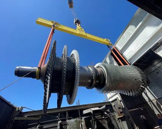

7FA Gas Turbine
Following turbine casing and bearing removal, compressor component inspection and repairs began. Inlet guide vanes (IGVs) were inspected and would be returned to service. IGV inner bushings and spring/thrust washers were replaced. Bearings were replaced as needed.
Oil deflectors and seals were prepared for shipping to MD&A Bearings, Seals and Hydraulics Division in Ohio for inspection and repair. New seals would be required.
Stator compressor blades S1-4 and S5-8 were worn and replaced. Several rows exhibited foreign object damage (FOD) and casing pinch marks, requiring precision blending and vane replacement.
For the combustion section, chamber components revealed wear and coating damage. MD&A experts replaced the following with either new or refurbished parts: liners, flow sleeves, crossfire tubes and retainers, liner caps, FWD cans, TP bull horns and transition pieces. Check valves were also replaced. Fuel nozzles were swapped and flow-tested to ensure proper atomization.
For the hot gas path, First-, second-, and third-stage buckets and nozzles were installed with concentricity and clearance checks verified against OEM tolerances. For the exhaust, flex seals were replaced with new pins installed, and the diffuser was weld-repaired.
A new Bearing T1 was replaced. T3 and T4 bearings were also transported to MD&A Bearings, Seals and Hydraulics division in Ohio, refurbished, returned, and reinstalled. The T1 thrust journal was also replaced.
Degraded gaskets were replaced in the discharge casing, and the casing received blend repairs.
MD&A Rotor Install
Rotor Install

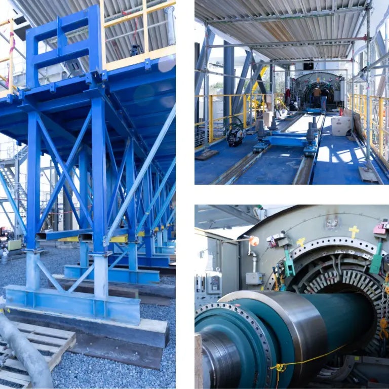

At project start, generator shaft jacking devices and eyebrows were installed. Our team constructed our generator field support platform to allow for easy removal of the field when performing this 7FH2 Generator Major Inspection.
This system addresses the unique challenges associated with the 7FA/7FH2 configuration:
  1. The shaft centerline height is 13 feet above machine baseline (grade)
  2. The gas turbine inlet ducting and filter house limit crane access.
MD&A 7FA Gas Turbine and 7FH2 Generator
MD&A’s team removed the turning gear and disassembled the journal bearings, and shipped them to MD&A Bearings, Seals and Hydraulics division in Ohio for refurbishment. Oil deflectors and hydrogen seals were also prepared for shipment.

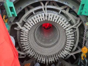

After end shield and fan blade removal, MD&A experts removed the generator field for covered storage on the turbine deck. The field was inspected, and field windings were found to be clean.
The generator end shields and gas shields were inspected, cleaned, and returned to service.
MD&A performed high-resolution borescope visual inspection of normally inaccessible areas on the generator, outside of the bore region. These areas include under the collector and turbine end retaining rings and the stator end windings, field coil end turns, auxiliary components and stator terminal connections.
The generator stator received visual inspection, insulation resistance testing, winding resistance measurements, DC leakage and RTD tests, and wedge inspection. The field received visual inspection, insulation resistance testing, winding resistance and impedance tests, and turn-to-turn pole balance.

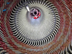

Stator testing revealed that more than one-third of the wedges were loose and/or hollow. MD&A experts therefore performed a complete rewedge on the generator stator. A full stator wedge tightness survey map followed.
The new turning gear was installed and aligned, followed by the hydrogen leak check. The gas turbine/generator load coupling was aligned to OEM specifications.
MD&A Rewedge on the Generator Stator
MD&A Completed Stator: New Rewedge, Painted
