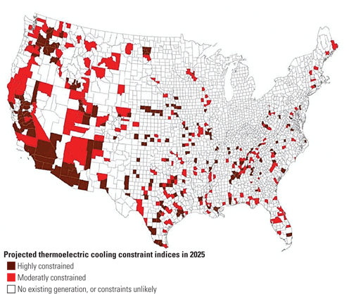

In a 2006 report, the National Energy Technology Laboratory (NETL) projected that the lion’s share of the new capacity installed between 2005 and 2030 will be in arid regions, including southeast, southwest, and western states. Those are the areas where adopting new water-conserving technologies will likely be most cost-effective for plant operators, due to the shrinking availability and the rising cost of water there (Figure 1).
1. Supply vs. demand. The Thermoelectric Cooling Constraint Index is based on the Water Supply Sustainability Index (WSSI), which takes into account the amount of available renewable water and sustainable groundwater use, limits on freshwater withdrawals needed to protect endangered species, an area’s susceptibility to drought, and its expected growth in water use and power production. An area is considered highly constrained if its WSSI is 3 or greater and moderately constrained if its WSSI is between 2 and 3. Source: NETL, 2006
