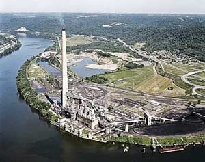

For that reason alone, cofiring biomass in U.S. coal-fired boilers should be viewed today as a serious option for reducing carbon emissions and as a strategy for meeting a renewable portfolio standard. That rationale was behind FirstEnergy’s decision to go even further and convert two units at its coal-fired R.E. Burger Plant to 100% biomass (see sidebar).
