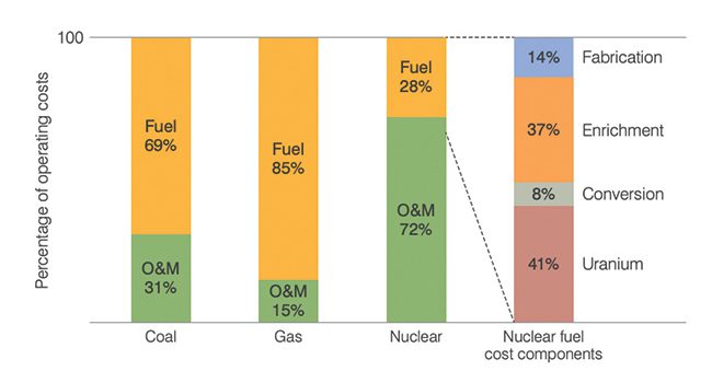

1. Ratio of fuel costs to operating and maintenance (O&M) costs for nuclear, coal, and gas generation. Courtesy: World Nuclear Association, Nuclear Power Economics and Structuring (2024 Edition)
Generally, “nuclear fuel costs have fallen over time due to lower uranium and enrichment prices together with new fuel designs allowing higher burn-ups, while O&M costs tend to be somewhat higher than for other thermal modes of generation,” notes the World Nuclear Association (WNA) in a report published in April 2024 (Figure 1). A major component of this has involved a dramatic shortening in the length of refueling outages. While in 1990, these averaged 107 days, the average duration dropped to 40 days in 2000. In 2023, in the U.S., nuclear plant refueling outages averaged 35 days, but plants have reported outages of as short as 16 days.
